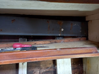

The aft cabin berths now half removed yo expose the original berth design underneath the berth design put in by a later owner
part of the original framework which is going to be re-instated later in the restoration

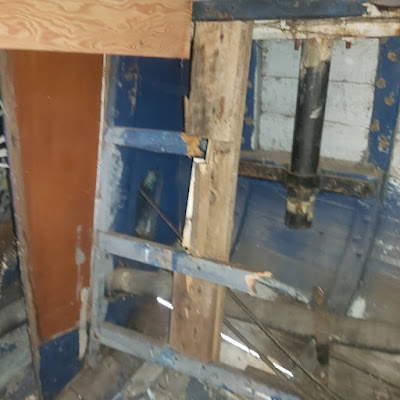

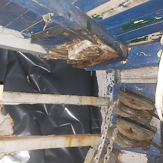

one of the original davit sockets still bolted in the boat

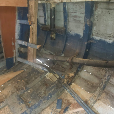

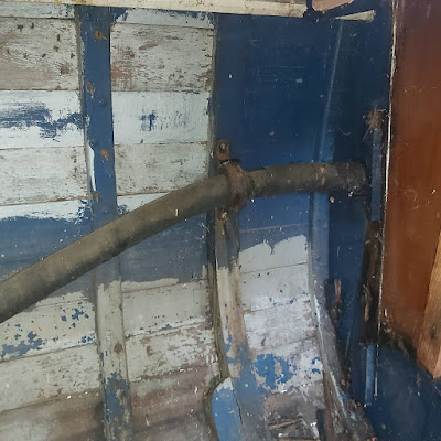

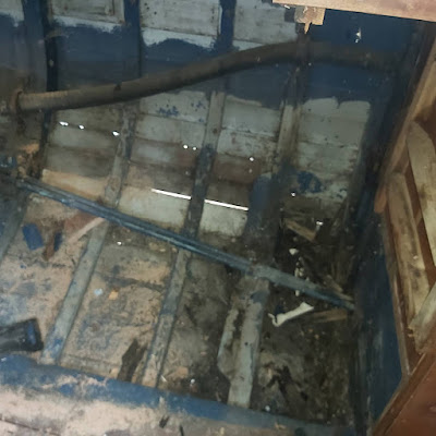

the steering cable tubes for the steering wires to run through

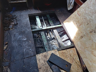

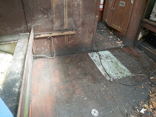

a good clean up in the aft cabin once the remaining wood is removed and a temporary floor is laid in place of th original floor boards which be cleaned and repaired as necessary

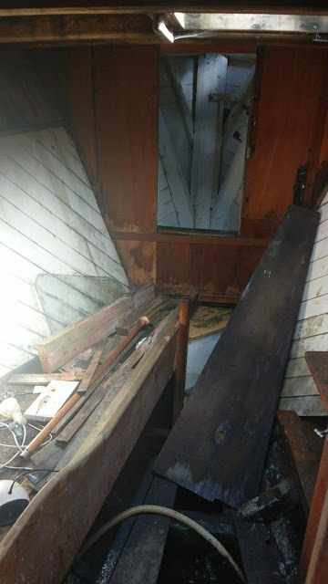

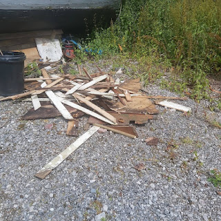

The pile of rotten and damaged panelling

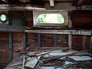

The after photo with the panelling gone and the gull able to air circulating round the inside of the hull for the first in over 20 years

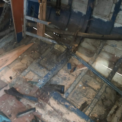

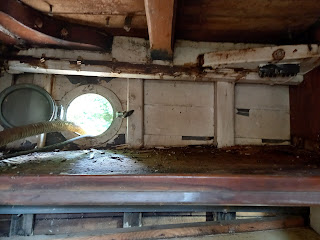

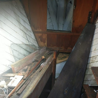

The aft cabin has had the berth removed to find the old position of the original berth design behind the more modern athwartships berth which is not the one Chance was built with in 1948

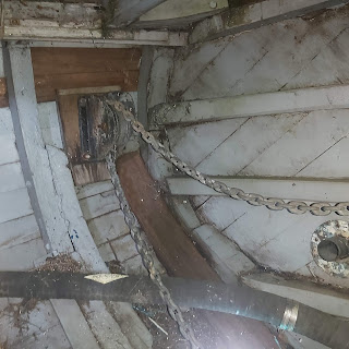

The original framework and paint work showing how it was originally made up
Major rebuilding needed in the aft end with a completely mew transom to be made and deck repairs needed for the davits can be placed on their original position

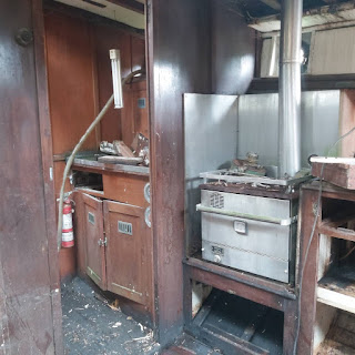

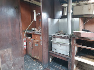

The major change in this area is to remove the diesel cooker and re-instate the cabinet work that was here when she was build and put the cooker back in the galley area on the port side where it was originally positioned

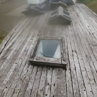

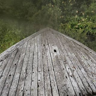

The foredeck hatches will have to be rebuild as the forward one is falling to pieces and is nailed down. So I will have carefully drill out he nail in the upper part of the hatch and carefully remove the hatch top and the base and take them back to my workshop to rebuild the hatch once more
The same is true of the galley and main cabin hatches, these to have been nailed down and will need careful drilling out of the nails holding the hatches down before ant work can be done on these beautiful hatches, They just elegant skylight hatches and show off Chances' beautiful lines

The vast foredeck which will be filled with the mossing deck fittings she once had when she was last in commission

First sight of the interior from last time I was on the boat.

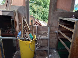

The first of many dustbins full of old bits coming out of the boat and going in the skip of metal srcap bin

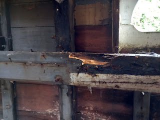

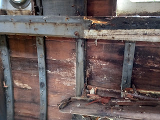

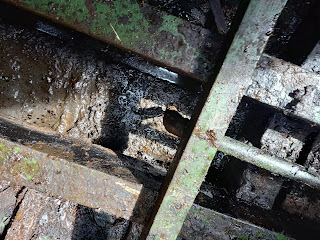

A small area of stringer with a small area of rot which needs cutting out and repairing
The hull planking as a area of rot which will removed when the planks are removed and the whole area is treated with fugal spore treatment to kill off any spore in the ribs or frames

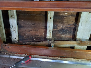

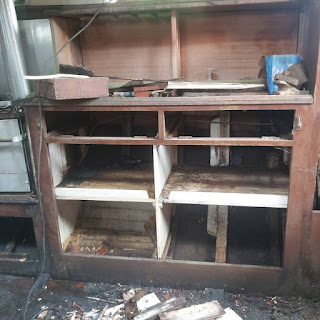

The whole area of the hull above the starboard cupboard now exposed for the first time since Chance was build and now the air can get to the hull to help dry out the area

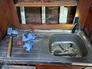

The galley sink is now removed and so is the upper cupboard so more of the hull is exposed to add getting to the plank fixings so that she can be re-fixed the correct way with copper nails and roves and not just screwed together which appears to have been done on some of the planking that as be replaced over the years.
The next three photos s show the galley upper cupboard being taken apart

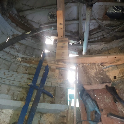

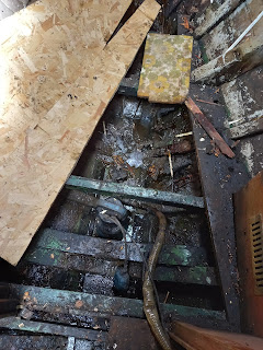

My brother john adding me with getting the interior ballast out of the bilge so the area can be cleaned and dried out and inspected

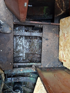

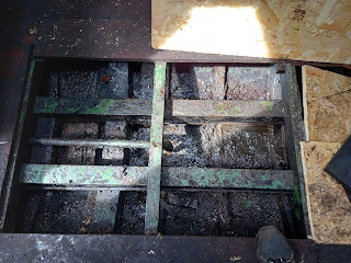

The next few photos showing the condition of the bilges once the ballast weights were mostly removed some of the remaining weights are in need of a bit more attention to get them out of where they are wedged in position
