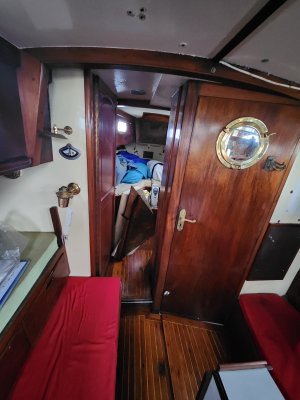

Evening all
I've just bought a Frans Maas Breeon 36ft for £100!
Her condition is excellent and the quality of finish is quite exceptional.
The layout is perfect for me and she exudes character though there is one issue I need help with.
She has an iroko wooden hull with a steel frame surrounding it, the frame is now rusty (well she was built in 1962)and it looks like steel pins were inserted to hold the layers of iroko together as rust spots can be seen.
Does anybody have any ideas for combating this problem?
