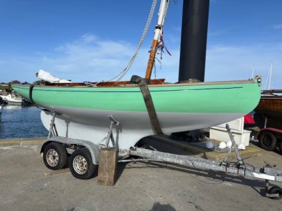

X66 isn’t going to win prizes for her looks, but the 9 year old paint is still on there. She came with about a litre left in the tin, for touch ups. That is nearly used up, what to do after that?

Is it unlucky to acquire one for very little that is already green? And sail her and win, for 9 years paying only for antifouling?
