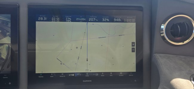

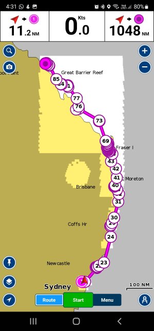

My opinion on the issue with the IPS drives suffering so much with fouling is that many manufacturers put the small IPS600s into boats that are really too big for them. As soon as there's any fouling, they're struggling to perform as the owner expects. My comparison based on two recent trips I've done here in Australia, Sydney to Whitsundays being about 1,000nm:
Riviera 47 with Cummins QSM11 660hp on straight shafts weighing about 20ton dry. Used 9,509 Litres
Riviera 5400 with D11 725hp IPS950s weighing about 25 ton dry. Used 8,208 Litres.
The larger boat with approx. 25% more weight used considerably less fuel. It'll be interesting to see if the fuel usage changes much when I do the return trip in November. The 5400 performs well with the IPS950s, I averaged about 26knots for the trip whereas the 47 was happier at 20-22 knots.
Paul.
