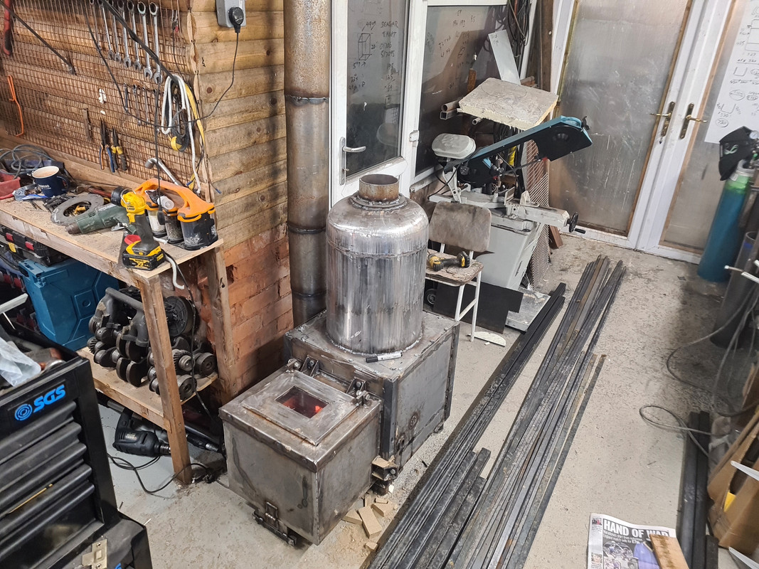

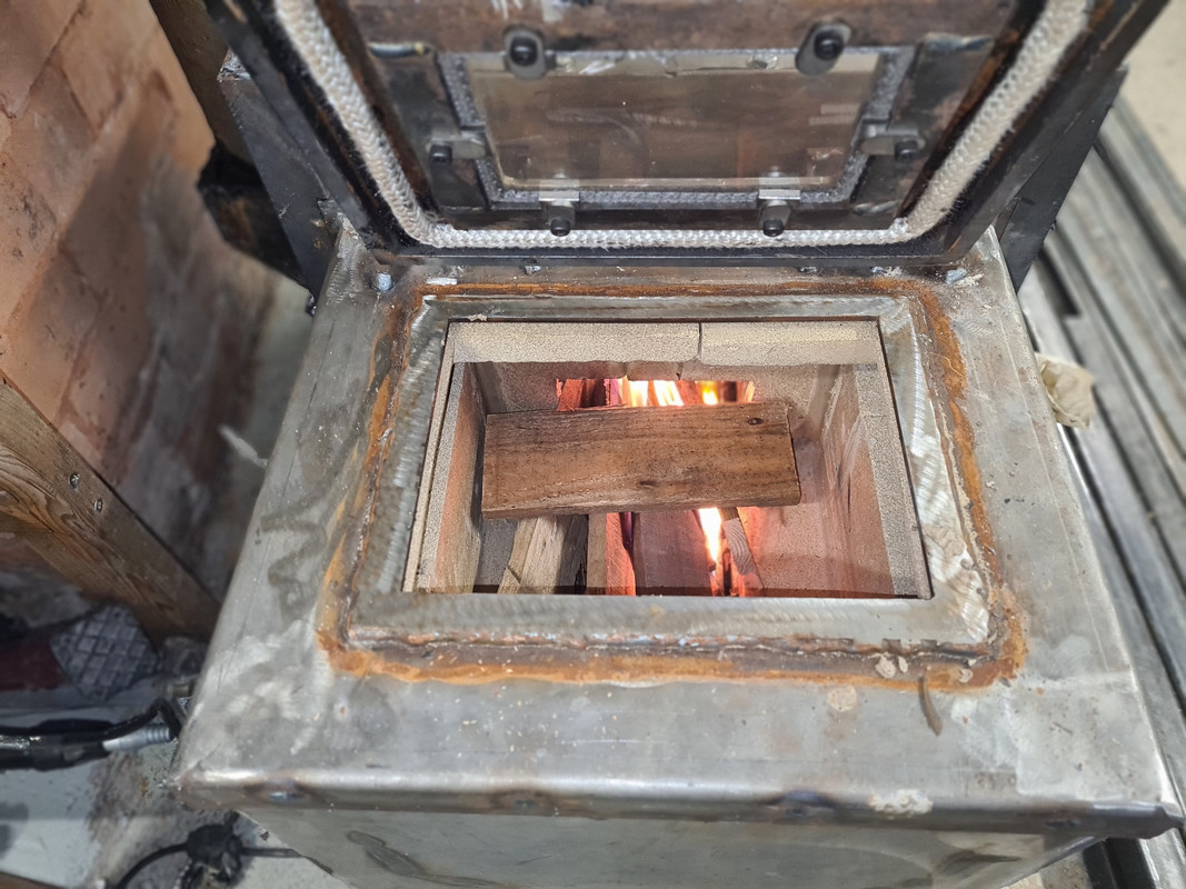

Or make a mini version of my Mass rocket stove stove which was part of a 47kg.
Kicks out big heat, burns atleast 50% less wood and smoke free :)

That looks good though not quite sure how it operates....... publish or be damned......!
ha ha i publish then as i do like to pop in now and then :)

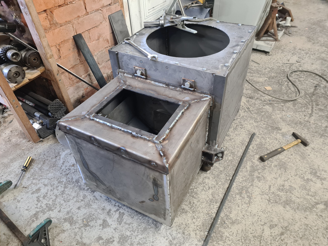

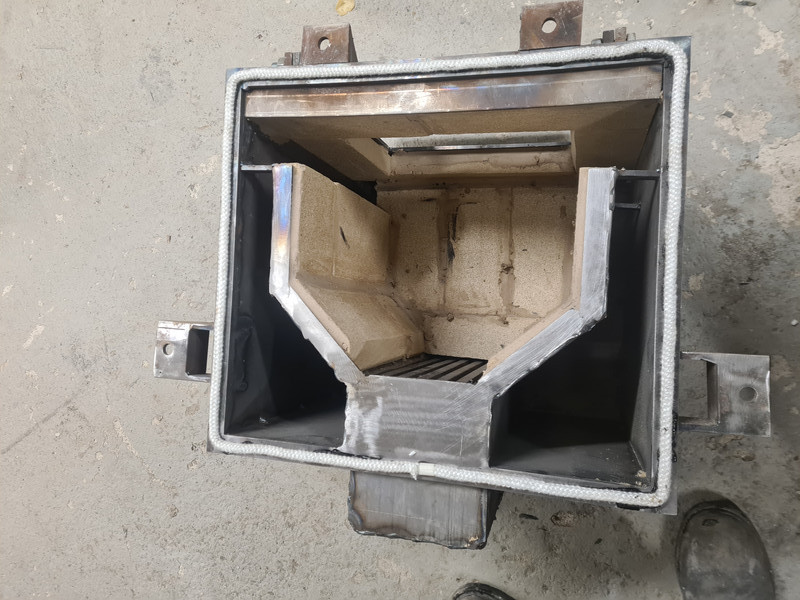

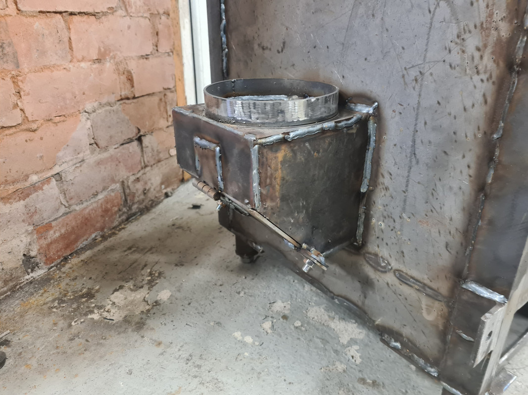

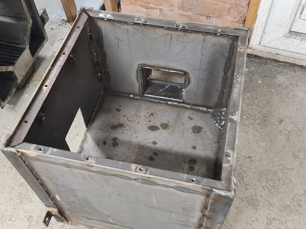

First chamber/fire box is well the fire box where the wood goes in.

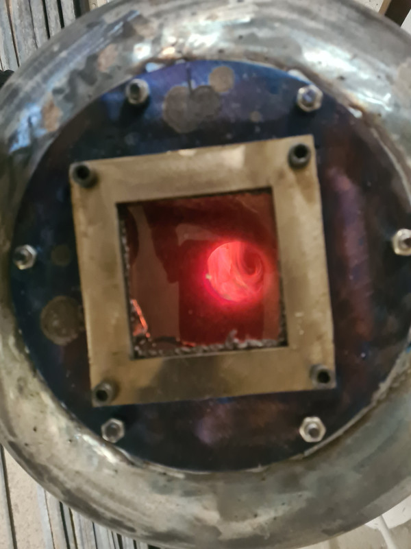

the burn tunnel which is tapered to a riser tube which makes the fire into a vortex. at the bottom it has a secondary air in take which burns the gasses int e vortex. hot air goes up the riser tube then down inbetween that and the outer ( gas cylinder ) heat exchanger.
then out the flue at the bottom.
Temps get to 460 Deg C in the fore box, heat exchnager to 230Degc. Flue max 70 DegC. I can modfidy it to get more heat out but in the shed is a T shirt job when its -5 outside so gets a bit warm.
In the riser it can get to 1200Dgec so i need to make aproper fire brick rise soon as this is made from 6mm steel which i am seeing how long it lasts.
It burns less wood as it also burns the gasses more than the wood.
few pics of the build
