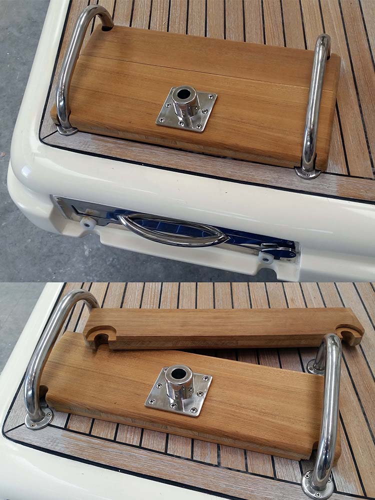

But since the final solution found together with my carpenter was also based on some suggestions received in this thread, I thought it's fair to show you the result - which I very much like, fwiw.
In the meantime, also the steel support for the passerelle was changed, and is different/smaller than the one in my OP, but it's the two parts teak base which was nicely shaped to self-lock in its place and do the trick, so to speak.
PS: With apologies for the greyish teak planks, but I already have a solution for that, based on many years of timber boat ownership:
I'll just give it time, and by the end of the summer also the passerelle support will be as grey as the rest! :cool:

Well spotted ref. the peculiar construction, but plywood it isn't, actually.
In fact, he built both blocks with three layers of 12mm solid teak.
The external ones (lower and upper) are well visible in the pics, with the grain along the longer side.
In between, there are several bits of planks, all glued together and with grain perpendicular to the external layers.

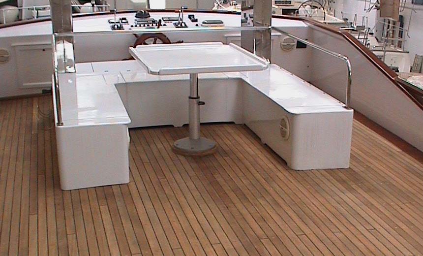

Btw, some 15 years ago, when he recaulked my old lady, he also rebuilt the f/b table base with the same technique.
The original one was cut from a single solid plank, and began to crack when the boat was just 5yo.
I'm afraid I don't have any better pics, but it's the round wooden base visible in the pic below, under the table pillar.
Anyway, that table base is nowadays as good and solid as in day one, so if the current passerelle base will be equally longlasting, that'll be good enough for me! :encouragement:

Though in this specific case, having been able to avoid any fastener altogether is the nicest (and more practical) part of the job! :)
