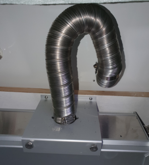

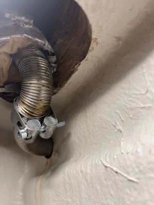

My boat, and heater is 13 years old now. When the wind blows against the outlet I get a bit of smoke coming out from the insulation tube covering the corrugated, stainless exhaust hose. The leak must be somewhere up in the upwards bend, as I can see or feel none along the end connections. I thought these hoses were supposed to be quality stuff that one did not have to worry about, but I seem to have been wrong? Do you guys know if there is biig quality differences among producers and what stores that peddle the good products? Now that I am about to change I would like to invest in something that will never fail me :)
The corrosion colouring on the hose is from the old hose clamp that was rusty. The hose itself does not appear to have any corrosion going on.
All stainless can rust if it’s not given an occasional wipe or polish especially if a layer of dirt or salt builds up. Looks like some condensation is running down the paint- is this coming through the pipe or forming on it ?
To be honest if it was mine I would replace the hose and outlet before even thinking about replacing the whole thing. No guarantee anything else will be good after 13 years let alone a lifetime.

The heater shown is a Wallas; seen as high quality, but no guarantee that the installation was good of course. I can't work out how the exhaust is routed. The Wallas system is to have the exhaust pipe internally co-axial with the combustion air inlet pipe. The two connect at a special external inlet / exhaust fitting. Any exhaust leak should be drawn back into the heater inlet. If smoke is appearing in the cabin, then something's badly wrong. I'd suggest that the installation should be checked for compliance with Wallas's fitting instructions.
You don't say what heater is fitted. Chinese heaters come with the thinnest exhaust hose that will hold together. Better hose can be purchased.

I am definitely getting a CO alarm! I am not sure about the condensation. Never seen any smoke coming from there. It is mall coming downwards along the insulation.

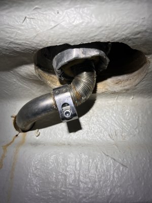

So I ordered new hose and drainage locks. But how the hell am I going to get the new hose through the goose neck? Insulation and all. Surely there must be some spesific method to it?
Looking at your image of the flex hose it is far to close to the plywood , which could burn at that temperature.

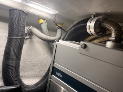

the wallas heater shown on the right, pic 1, has the exhaust exiting upwards from the top of the unit, where does that go ?
the swan neck on the left is part of what ?
Oh, I just relized that the picture was not very explanatory! Thank you for that :)

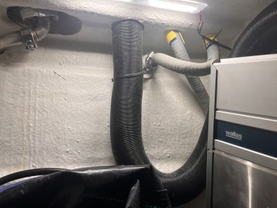

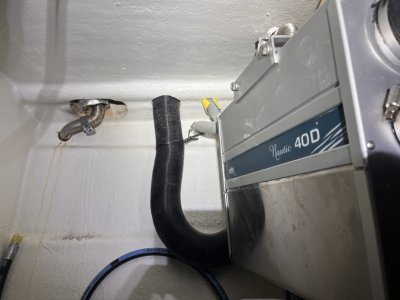

As you hopefuly can see in this picture, it goes in through the black insulated hose, and then up and away in a goose neck. If I pull it all out I fear that I will never get a new one in place whitout cutting the boat apart^^

Yeah, I suspect condensation is the reason the hose has gone bad. So when redoing it I am fitting a drain! Will do the same for the wallas stovetop. On the exhaust from that you can see rust on the outside, and I have drained it a couple of times by disconnecting it from the stovetop.
