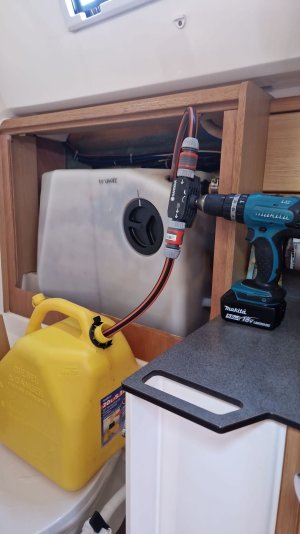

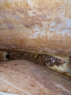

We borrowed a friends boat and spent the first 2 days of our holiday this year trying to get a holding tank full of scale to empty, this included lying on a SUP next to the boat with a hose rammed up the waste outlet blasting sea-water back into the holding tank.
Not a nice job at all :sick:🤮
For your delectation, a photo of the tank internals showing all the non-organic crud in the bottom, and the pump used to empty it out of sight in the marina. This boat is only 8 years old.
