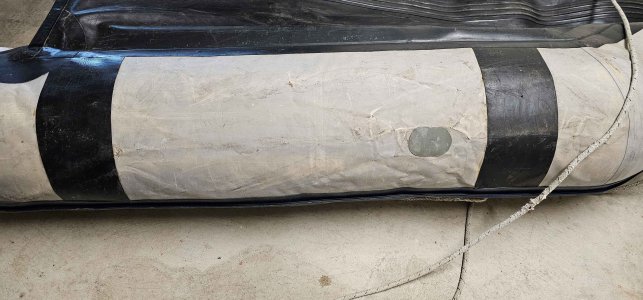

Hi, I've just pumped up my Seago 270 inflatable dinghy, and noted that one tube is very badly damaged by UV.
The tube is exposed to the sun when the dinghy is strapped to the transom, so no real surprise that it has deteriorated more rapidly than the rest of the dinghy.
It now leaking air through the fabric.

In the NW of Scotland, we can have 18hrs of sunshine a day in mid summer and the atmosphere is generally less polluted than other place in the UK, so the UV radiation dose can be high, I've had three PVC Seago inflatables, and they generally last about 5 years.UV damage to SEGO 270.jpg
The damage is so bad I can't pump the tube up with foot pump. The black bands are reinforcement I added to protect the dinghy from the ratchet straps I use to hold the dinghy onto the stern of the boat. The UV has taken much of the top layer of PVC off and you can see the textile reinforcement. The fabric is quite brittle and easily punctured.

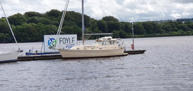

We store our current dinghy, a Talamex Superlight-it only weighs 14 kilo's-upside down on our pilothouse roof.
We bought some special colour coded fabric, cream so it matches the boat, and First Mate made a simple cover to keep the UV off while on the roof.
The dink is black, so is a heat sink in the sun.
The pic below shows it stowed on the roof.
