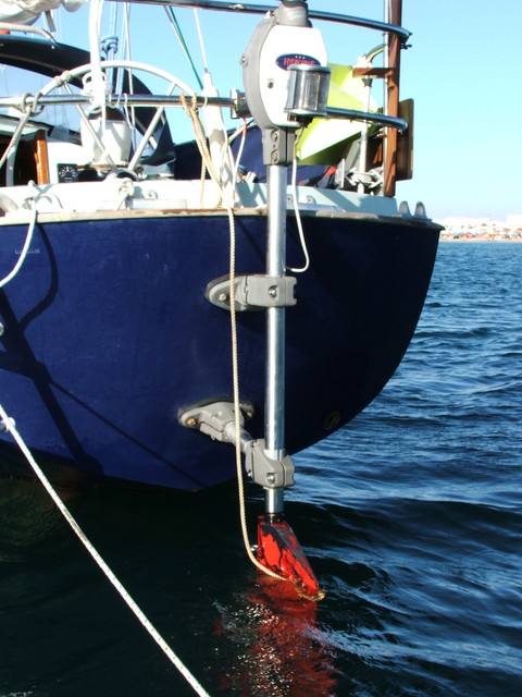

I have had Hydrovane steering on two boats, a 35 foot steel Gaff Cutter and a Nicholson 32. I fitted the gear myself on both boats. On the first occasion I ordered the gear via the Hydrovane website..But..Hydrovane at that time was owned in England, later it moved to Canada. I went and collected the second set of steering gear at point of manufacture in a small engineering shop in Nottingham, later as stated the ownership of Hydrovane became Canadian although...I think, manufacturing was still done in England.

Prior to fitting in a Sussex Boat Yard.
Some months later down on the Algarve, Portimao anchorage I think, or it may have been round in La Linea, not sure now.

The usual advice...Measure carefully before drilling...but fitting to both steel and GRP I managed, alone, quite easily, taking it slowly and don't be afraid to contact Hydrovane for advice, I found them really helpful

I fitted mine to a stern with curves in two directions. No way was I going to get hardwood to fit properly. I fitted the vane temporarily and made up some thick epoxy and filler and put this into a plastic bag and then put the bag between the vane support and the hull. When it went hard it just needed cleaned up a bit and was a perfect fit to the hull. Then did the other support.
