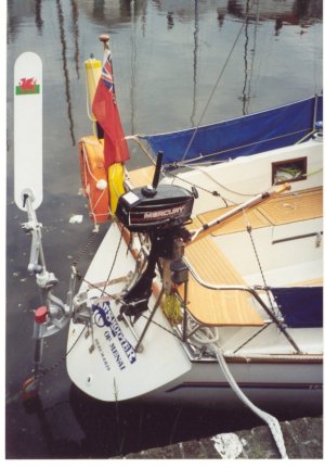

Your sugar scoop is bigger than mine but this is an aries lift up which is now for sale as the boat is being sold. But one can adjust the dimensions as required
It demonstraits how mine has been for 15 years. I did fit one to a friends 40ft Jeneau for the ARC & we used Key Clamp GRP tube & fittings to make the support framework
My one works just fine & the oar swings 4 times when released
The top hs been removed for storage & access over the stern

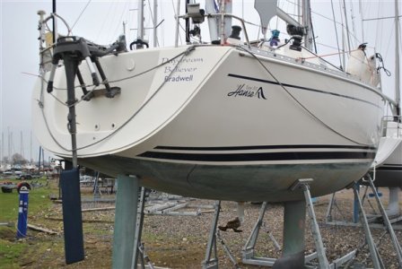

Fact. Look at my 30ft (NON round the world!) light displacement tiller steered boat. Your sweeping statement was about below deck auto pilots which are indeed things of marvel. When the winds up with some North Sea chop, my otherwise excellent Ev100 tiller pilot is sometimes over powered. My Sailomat windvane copes better. Daydream Believer, who sails in same area as me, often says the same of his Aries.

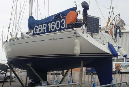

Hydrovane will certainly fit. Went across the pond on my friends Moody 38cc which has a very similar stern as the boat pictured. The hydrovane was the best investment he made for the trip. Amazing bit of kit.
Try posting on the moody owners forum, or get in touch with Hydrovane for advice.
