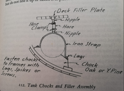

Something like this*, adapted for your GRP hull:
*From "Boatbuilding" by Howard I. Chapelle

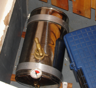

I secured the cylindrical fuel tank for my Taylors cabin heater using this method with s/s straps.

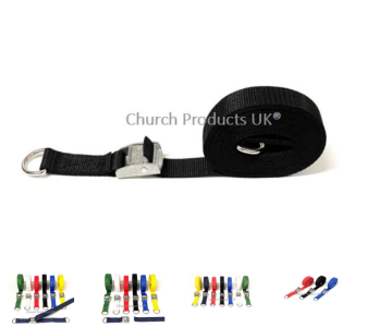

If I was doing the job now I might use something like these instead of the S/S straps (provided I could find some with s/s rings and buckles).

I would use seat belt webbing to attach the tank to shaped mount blocks as in the diagram. These can be glued to the GRP with a wooden bar across the bottom also glued to GRP. Dependimng on hopw much support your shaped blocks give the webbing can be sewn in a loop with cord lashing to tension it. ol'will
