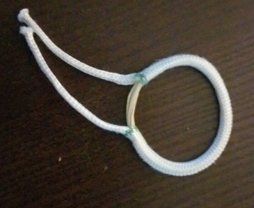

In the absence of lump hammers or competent welders, take a thin dyneema braid and give it 10000000 turns between the two end links kept at the right distance :)
Example, **very** tiny loop with aramid monofilament wound inside a dyneema cover (mainly for chafe protection), the two white tails are then buried in the loop. The cover in the photo is 3mm dia. It can be made (almost) as small as one wishes, no need for bury/taper minimum Xdiameter like with dyneema braid loops; make one fit to fill a chain link the chain will break first somewhere else, and you have an enormous safety factor anyway. No rust nor galvanic effects. Ok apart from chain it can be quite useful :)
