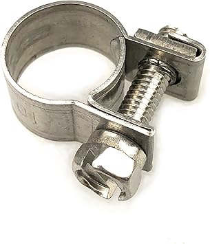

But rather than worm drive I would use fuel line clips. The saddle on worm drive clips, in smaller sizes, prevent even clamping pressure.
Even better are spring clips, provided you get the right size.
Or could I just cut out a length from the metal line, and replace it with a short length of rubber line? If so, how do I get a reliably leakproof connection between the the two fuel lines? Could I just push the rubber hose over the metal line, and secure it with jubilee clips?
Yes, you can do it this way, i would use fuel line clips, as shown in the first pic, post #3, make sure they are stainless.
