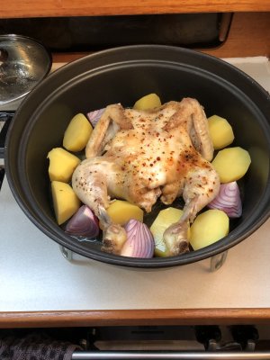

We also started small with 45w of second hand solar which worked and kept the batteries topped up on mooring with no power. However, the revelation came when we installed 300w and an inverter. That enabled the use of a small electric kettle and induction hob which more than halved our gas usage, brilliant :D
Next came concerns of our then 33 year old gas Atlantic cooker. The grill was rusty and the oven rubbish. Since the only thing holding the gas inside was probably some o rings and worn brass valve components we replaced it with a new gas hob and grill. Then discovered a Remoska, bought second hand for £60. Memsahib turned her nose up at it, that was until I cooked a full roast dinner with it, then suddenly it became the best widget ever. We even bought another for use at home.
Some how we melted our shore power cable, only discovered on arrival in Bembridge for a long weekend. Okay lets go pure electric cooking for 3 days and see what happens. Well, 300w wasn't quite enough but we coped and the batteries took the strain meeting all our needs. Last winter we increased the solar to 590w and added a second LFP battery. Took out the gas grill and added a double induction hob, which works really well in conjunction with the Remoska.
We consider this very much a science project to see what can be achieved on a 31ft yacht. It won't be for everyone, but even some solar and an inverter enables a mix of gas and electric, even if its just using the electric kettle and the reduction in gas means less faffing around changing cylinders.
Roast chicken cooking on sunshine?
