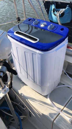

590w of solar AND a washing machine... on a 31ft boat... that's quite impressive.
I got so fed up of trying to find launderettes or waiting for the machines in a marina we took a gamble on one of these plastic things. Plus we are trying to use expensive marinas less often. Reviews weren't great of any portable machines, but I recon the break even point is about 20 washes, we are up to about a dozen so far. Quite impressed really, lighter than the little Honda outboard so easy enough to lift in and out of the cockpit locker and very quiet in use. No problem sitting next to it in the cockpit and having a normal conversation, can't do that at home.
Our other power hog is the second fridge/freezer. We have just finished munching our way through enough food to revert back to one, after I went a bit OTT on a shopping trip. Finally we use a 240v air pump for inflating the dinghy rather than faff around with the foot pump. Makes life much easier.
I think one of the problems is mission creep. You can do all the maths you like to try and work out how much solar you need, only to then add another item like a freezer and the numbers go out of the window.

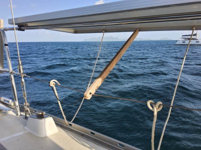

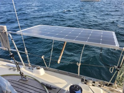

I'm particularly interested on lifeline/stanchion locations as I've never seen anyone doing it, but lots of words on forum - and framed solar are not light.
It's pretty common here in the Caribbean.
I've seen all manner of methods, including fancy mounting frames, friction clamps, etc.
But simple works too. These panels are not all that heavy- about 7kg for a 100w rigid. If your guardrails cannot support that 7kg supported between two points a metre apart, then I would not want to rely on them to keep people onboard, or even to tie fenders to.
My initial setup simply used a bulldog clamp as a u-bolt, through two holes drilled in the panel frame, to hold it on to the wire. I had a convenient high point to attach a bit of string to hold the panel up.
Later, as part of creating the bimini, I added a steel tube in parallel with the top guardwire, and now the panels hang from there. I just made U-bolts from some threaded rod I had.
I've never had any worries when rafting up. Probably depends on the design of the boat. We're old enough to narrow a bit at the stern, so the panels don't actually come anywhere near your neighbour. We're also pretty high out of the water.
And even if a panel did get damaged, I wouldn't lose too much sleep over it. They're one of the cheapest things on the boat so I'd actually much rather somebody hit a panel than just about anywhere else.

I was not worried about the strength of the stanchions more the load of the panel, 7kg stuck out as a lever, and how to support, or you support, in, say, chop.
Thanks, answer understood. I had assumed a strut at an angle off the toe rail but you are hanging them from 'something' above
Jonathan
We do ours like thisreceived_761418442418221.jpegreceived_155269990954538.jpeg
Jonathan
A strut is probably a more common method, and removes a source of shading. My ~3mm line doesn't really throw any appreciable shading, although I have had one chafe through and snap in the past.
(No harm done, by the way. Rigid panels are surprisingly robust).
