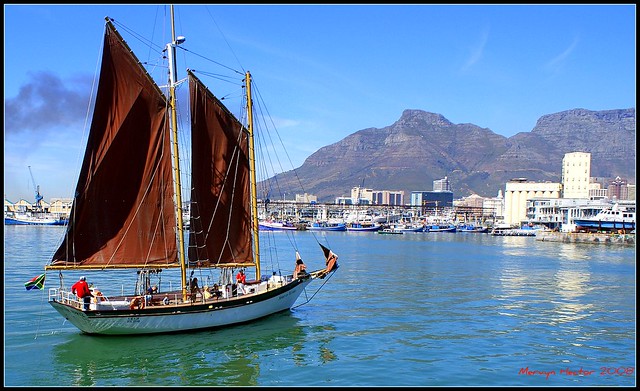

Not sure how I came to find the photo but it's such a good one, I had to post it here. The boat looks like an oldie, but it's actually a Dudley Dix Hout Bay 50ft, given the 50-passenger day-excursion treatment. She could alternatively be built with comfortable, even luxurious accommodation for up to eight without diminishing the traditional appeal...so I wondered how costly such authentically rugged construction must be, if a buyer chose not to specify a lot of modern electric gadgetry.
The website was last updated five years ago, so the yard may not be in business...but plans needn't go out of date... http://www.dixdesign.com/hb50.htm

She's not as tough as she looks. The hull plating is only 5mm on the commercial version (4mm topsides on the yachty version), with 3mm deck plating, which is very light for a vessel of that size.
But presumably if she's rated as seaworthy with ten tonnes of cargo aboard, thicker hull plating could be used for a version which wouldn't carry cargo, without being overweight?

Admittedly the photo I posted above doesn't show much of the schooner's topsides. But I thought steel construction at this scale necessarily required acceptance of rather plain, angular lines, caused by the two-dimensional chine-configuration of a hull built from plate steel. This design looks much prettier than that - so I'm excited by what's possible.
