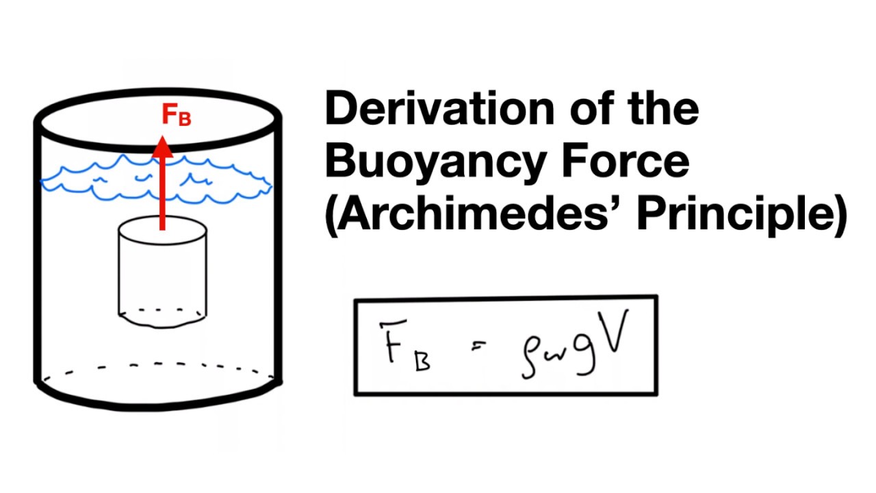

The original question is "What is the weight of a 40kg anchor in seawater."
Any iten when submerged in any fluid will be subject to 2 forces.
1) Gravity
2 Buoyancy
the weight of a 40 kb anchor under gravity will be err 40 Kg
Buoyancy based on Archimedes principle is F = fluid density * acceleration due to gravity * fluid volume.
You can work out the formula or determine the reduction in weight by dunking your anchor in a tub of seawater and measure the displacement volume the increase in depth of the sea water.and multply this volume by the density of the sea water displaced.
You could also collect the increase in sea water volume then weigh it.
deduct the weight of sea water displaced and from the 40 Kg will give you the weight of anchor submerges in water

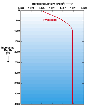

Don't forget the density of sea water various with the location around the world as in the plimsoll line on the sides of ships
Density is lowest at the surface, where the water is the warmest. As depth increases, there is a region of rapidly increasing density with increasing depth, which is called the pycnocline . The pycnocline coincides with the thermocline , as it is the sudden decrease in temperature that leads to the increase in density.
