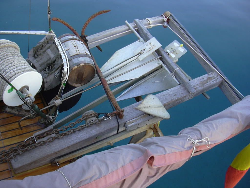

Kedges.
Pic of our kedge arrangement. http://i1155.photobucket.com/albums/p543/OldBawley/DSCN1698.jpg
Nr 1 a Northill, 7 m chain, 60 m 12 mm multiplaid on a drum.
Nr 2 a huge aluminium Viking, ( Sort of Fortress FX 55 ) on 17m of chain and 45 meter 14 mm multiplaid on a drum.
Nr 3 Small fortress fx 16, useless, to light.
Nr 4 a Med style rock anchor. Used with 10 mm light chain and 40 m of warp.
We mostly moor bows to on town quays, our bowsprit is an excellent passerelle. On approaching the spot I want, a pull on the securing bar launches the big allu anchor, the chain and line goes down with it. The line is taken over a sheet winch and roles out automatic. About one boat length from the quay I bury the anchor just by holding on to the line, the winch takes the power.
That way I can stop the boat with prop still in forward gear ( Very slow ) and adjust the distance bowsprit – quay with one hand, steering with the other.
At the right spot, with the prop still in forward ,the line is belayed, then I walk forward and step on land to belay a bowline. Only then the gearbox is put in neutral and the engine stopped.
One problem with mooring bow- to is that some jerks sail there boat so close to the quay that they gut stuck in our kedge warp with there keel. All chain would be better but is more difficult to control running out.
The stern anchor is taken back on board over the roller. By hand, witch is sometimes a real hard job.
Getting older all the time, I have to start looking for a small anchor winch.
All kedges are often set from our rigid dingy who has a sturdy roller for the rode in the stern.
The contraption at the back of the boat was fist only used to sheet the yawl sail. It is never used as a pram handle. Now it carry s the kedges, can lift de dingy.
Last year I made three new bearers out of 3 x 9 inch iroko to replace the old ash bearers seen on the photo. Just last week I suggested to build a chicken house on it. Small and yachty, you know.
Swimbo says she will leave me forever if I do.
