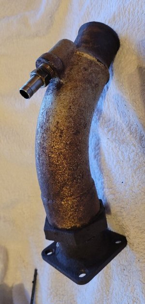

What would you 'rude mechanicals' use for on the threads of a screwed connection in an exhaust system, such as that shown below.
It is for a BUKH DV10.
In the past I have used Coppaslip, which I happen to have on board, but whenever I needed to remove a cracked exhaust elbow (something that happens every few years) I have never been able to unscrew the elbow with the tools I carry on board and have ended up breaking it off with a hammer and cold chisel.
Obvious problem is the heat. My first thought is some sort of paste. There was "Gun Gum" for patching car exhausts but that set very hard which isn't what you want. I can't think of a high temperature non-setting paste at the moment, there must be something.
Duralac everyone rating this stuff. I haven't used it as yet tho
