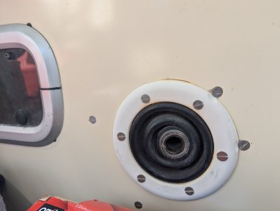

Hi, I was reading this old thread and wanted to find out if Boo2 resolved the Henderson MkV Bilge pump replacement?
I also have an old MKV bilge pump but after reading this forum and checking, I see that the mounting brackets on the current model are different which would require reconfiguring how it is currently fitted in the cockpit!
I was hoping that the repair kit would get me out of trouble but having bought the standard repair kit here in Australia whale-mk5-single-action-spares, it does not contain the locking nut I need to hold the pressure plates onto the diaphragmn. Looking at the Whale website it appears that I would also need to buy Service Kit AK8050 which contains the Diaphragmn and Valves.
Given that the standard repair kit cost A$99.95 I shudder to think how much the additional kit will cost. A new MKV retails at A$159.95 so the question I have apart from the mounting brackets on the new MKV are there any other changes from the older model i.e. if I bought the new MKV can I use it to substitute the parts that are damaged on my old version?
Happy holidays to all and here's wishing for a speedy response:)

If you are looking for the center nut which is plastic, I had the same issue when my nut broke.
I made the fitting that the nut screwed on o in stainless using a metric nut so problem solved.
I did find the nut in question to be if I remember correctly is in fact 3/4: Whitworth so could be replaced with a stainless steel Whitworth lock nut if you can get one.

Thanks mate, unfortunately my outlet valve and diaphragm plates were also worse for wear so after weighing-up the time and expense trying to replace them together with the nut, I've ended up buying a new MKV to swap out the parts. Hoping that I can keep using the old cover with attached rocker arm to avoid reconfiguring!
