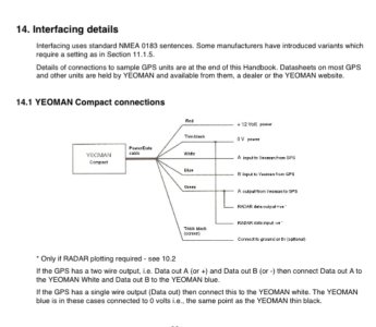

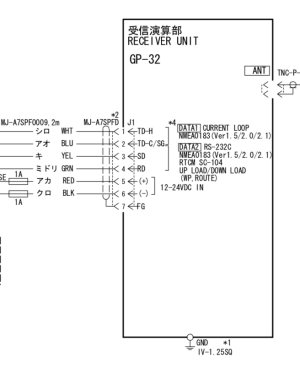

Never the best at electrics, and always struggle a bit with Furuno’s connection diagrams, so if anyone could help I’d appreciate it. I’d like to connect my boat-jumble find Yeoman Plotter to the Furuno Gp32 on boat for A GPS input to the Yeoman.
Here’s a diagram of connections for both devices:

I have a GP-30 and a Yeoman Pro. The wire colours you need for data transfer are green to green, white to white blue to blue and screen to screen. My Yeoman receives the GPS position, but I haven't managed to send waypoints back to the GPS set.
