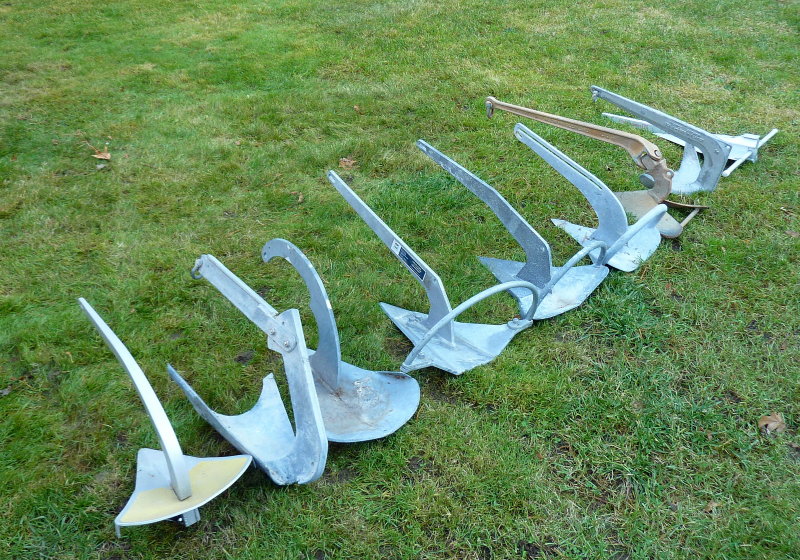

I have lots of boater "experience" with many anchors in soft mud, had bottoms, gravel and eel grass. Maine has quite a variation of bottom types. I choose to use a Fortress as my dedicated stern anchor but it has failed to re-set on me far to many times to trust it while asleep. When an anchor fails me more than just a few times, I keep searching.
To that end I own and have owned Delta, Bruce, CQR's, Danforth's, Fortresses, Super Max, Manson Supreme, Spade aluminum and Spade steel and a Rocna and some others.
By quite a wide margin the Manson Supreme and the Rocna have been the best all around performers. I now have over 400 anchoring events between the Manson and the Rocna, in most all bottom types and have not yet had a drag, failed reset or a missed set on the first try (except for when I caught a lobster trap). I can't say that for any of my other anchors except the Manson Supreme and the Rocna. I know Craig hates the Manson but it is what it is, a damn good anchor.
I know the Fortress has tremendous holding power but it fails me when it needs to re-set reliably and I can't have this. Both my Rocna and Manson have sustained winds over 55 knots in soft mud and not budged an inch. Years ago we rode out 50 knos on my Fortress and she held great. After the storm the winds abated and over nigh changed direction and came up at 20 knots from the opposite way. Something did not seem right so I popped my head out of the companionway and we were 30 feet from a ledge and over 1/4 miles from where we rode out 50+ knots on the same anchor. I scrambled to fire up the motor and only scratched the bottom paint on my keel. That was the last time I used my Fortress as my primary anchor. If I had not woken up early to take some photos we would have had thousands of dollars in damages. I got darn lucky.
I really liked my old Bruce as it set & re-set very reliably but holding was a tad light and I really did not want to have to go one or two sizes larger to get what I wanted in holding.
Someone will improve on the Rocna/Manson concept but for now they are the most reliable anchors I have ever used.
I still own quite a few anchors and can choose to use any one of them as my primary as they are not for sale and owe me nothing. I will continue to use my Fortress as my dedicated stern anchor because it excels in this regard but it will never again be my everyday primary anchor.
