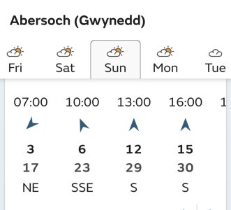

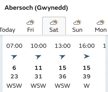

Notwithstanding that this isn't a good day for forecasts, this is an example of the dilemma which seems to have become more common to me this season.
These are extracts of this weekend's Met Office forecast for Abersoch (N Wales).
Screenshot_20241010_161948_Met Office.jpgScreenshot_20241010_161958_Met Office.jpg
The dilemma is the scale of difference between (average?) wind strength in knts and the gusts. On my own I would sail and deal with it (at anchor somewhere safe). For inexperienced crew it could turn into a scary endurance mission.
On several occasions this year I have sailed in similar wind forecasts sometimes encountering the lower figure and on others the higher figure (sustained).
I sense that the UK wind (West side at least) this season is genuinely varying by such extremes and that the models struggle to deal with the volatility.

Thank you for this. I have been hesitating to suggest that some of the examples of strong gusts quoted earlier in this thread were, in fact, quite possible. When there is deep convection, stronger than normal gusts are always a possibility. I have no idea whether this is a climate change effect or not, I have no idea. It could well be normal variability.

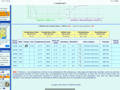

There are some pre-conceived ideas about gusts that are ill-founded. I would not regard 15 with gusts to 26 as unlikely. I have seen actual reports of gusts being twice the average wind. Given the quality of Met Office scientists, I suspect that their gust forecasts should no be disregarded. A good source of latest actual data is Meteociel - Observations des rafales de vent en Royaume-Uni en temps réel. Select a location to get a table of recent data.
I did this just now and happened on Sligo Airport. See the image attached. Gusts nearly double the mean wind!
