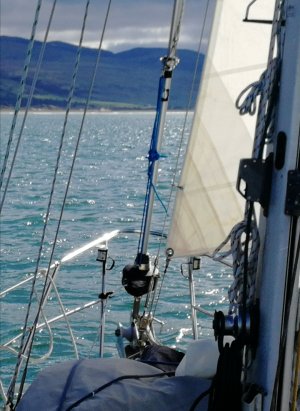

I have a removable Solent stay and hank on sail, and a deep, wide foredeck with bulwarks and guard wires. Handling hank on sails is not a problem for me. I like the idea of reef points. Removing the stay back to the shrouds takes away a lot of clutter. I use it a remarkable amount. My genoa half furled seriously damages windward ability.
