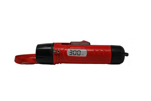

Thanks for the quick and helpful replies. I am particularly interested in any opinions on the hand held devices that look like a torch that do not require any attachment to the hull and operate off a couple of AA batteries. ( https://i.ebayimg.com/images/g/ptwAAOSwv4FckC8G/s-l500.jpg )
The portable Fish Finder Sonar Alarm looks handy for fishing from a static position but I suspect troublesome being towed up a weedy creek.

The red one in the photo looks like it has a small metal ringed hole on the side. Is that so?
If so, how can it be waterproof and submersible do you think? I could be wrong about the metal hole of course.
Good point. Looks almost like a small brass Grommet in the plastic. I'm not familiar with the red sounder, it's just an image I found to clarify what I was wittering on about in my first post. I think that illustration may possibly be of a Chinese copy of the American 'Hawkeye' design hand held sounder and sold under a different brand name. My search so far, indicates a Plastimo model in a fetching bright yellow is favourite.
