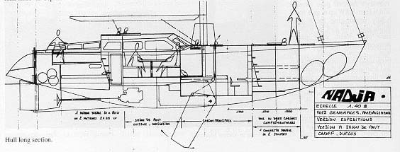

Nice thread. This is a (pipe)dream of mine too. I want to go in one of Gilbert Caroff's aluminum hulls with a retractable keel. Probably a Chatam 40, if I can find one I can afford.
This is a Chatam 40 (that I can't afford):
and this is Northabout (designed by Caroff):

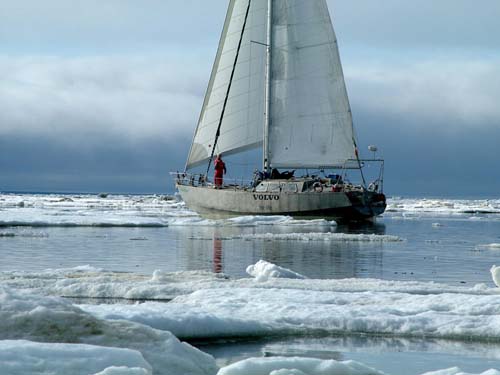

We have left our boat on the west coast of Greenland for this winter (in the water in Nuuk, but not staying on board). Ours is a 42ft steel sloop, but there were several GRP yachts in the area - probably 1 GRP for every 2 steel or aluminium. Here are a few comments related to other posts - just my views :) based on personal experience.
In the latter part of the season (mid Aug to early Oct) ice is not really problem on the west coast or SE coast of Greenland - the glacier ice is easily avoided. There is no ice at all on the Baffin Island side from mid August and between the Canadian Islands and Greenland it is ice free to 78 N in mid Aug to late Sep. Note that earlier accounts of difficult ice conditions relate to conditions 10 or more years ago which were quite different to current conditions.
There is no SAR bond required in Greenland, and there are local rescue services and support from the Danish Navy. Very little SAR on Canadian side/Baffin Island except further into the NW Passage where ice breakers stay on station through August/September. There is good local and offshore radio coverage, and reporting systems in Greenland, but next to nothing in Canadian waters.
Polar bears are not generally an issue on the west coast of Greenland until very far north as the locals tend to shoot them all. On the northern east coast of Greenland (the national park area) there are bears. Baffin Island east coast and Canadian Islands have many polar bears (we encountered 19 all up). A shotgun with slugs is way more powerful than any rifle for a close encounter with a bear (i.e less than 10 metres) but of course less so at longer ranges as energy bleeds off very quickly. A shotgun has the advantage over a rifle that it can be loaded with a range of shot types (assuming 5 shot magazine in a semi-auto or pump) - one or two bird shot for noise, 1 or 2 slugs for when the bear is charging at you, and a final 1 or 2 large buckshot for the last couple of metres before you die. Americans and Canadians tend to favour shotguns for bear protection, whereas Europeans favour rifles - maybe more to do with firearms law than anything (slugs and 5 shot shotguns not legal in UK). Polar bears are aggressive in late summer with no ice and therefore no seals - way more so than grizzlies - and in a close encounter (e.g. unexpected meeting at a few metres) you can be at serious risk. Bear spray is a good option before firearms.
Diesel fuel is very readily available in Greenland at every little village and port. It is also very cheap - around US$1 per litre equivalent - way cheaper than US or Canada (and Europe I guess). So I don't see extended fuel capacity as essential for Greenland.
Water is harder to get both in Greenland and Canada - mainly because there are no external hoses and taps at docks and harbours because of the winter freezing. So you need to get it from a fishing boat, fish processing plant, or carry it in jerry cans, or have a water maker. We have an engine driven water maker rated at 80 litres per hour. It does 100 litres per hour in the tropics, and did 65 litres per hour in the arctic with water temperature down to 0 deg C. Some cruisers have reported very poor water maker performance in cold water (and even installed pre-heaters) but we found this not to be the case. I would rate the water maker as one of the great life enhancers in the arctic. We supplied water to some other cruising boats.
Wind and weather protection is a great life enhancer also. We had all-round plastic clears made for our cockpit in Canada and have found these to be fantastic. The cockpit becomes another usable room is all weather. With the diesel stove going down in the cabin we might have 18 deg in the cabin, 12 degrees in the cockpit (with clears up) and 4 degrees outside. It is nice not to have all crew members having to get the full foul weather gear on every time you are underway - only the one on the bow getting up the anchor sometimes!
