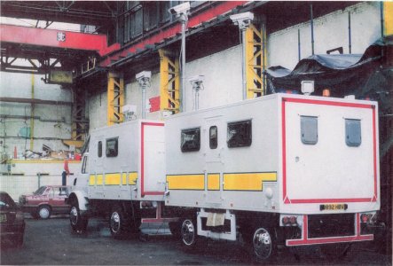

In the motor trade they use Sikaflex to glue the refrigerated backs to lorries, the frame round the edges are pop riveted but it's Sikaflex that is holding the backs of this together
This is one we built earlier :)
