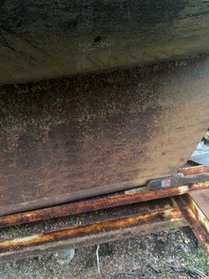

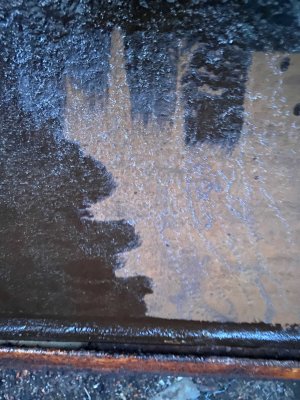

Hand wire brushing of the starboard keel. The light coloured bits seem to be residual galvanizing. Oviously much rust remains.

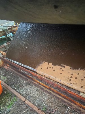

Overpainting with SFO. Heating might have improved penetration but a brisk NE wind with rain defeated that idea, and it seemed to soak in OK. Left for 2 days. Note the splashes

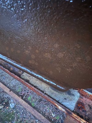

Note the light coloured areas corresponding to the splashes. I'd guess these are trapped air and its better to paint from the bottom up.
"Aluminiumising" after 2 days. Rainwater beading on the surface and some washover didnt seem to be a serious problem. After application some rust coloured aluminium-free pits were apparent, which were filled by overbrushing another layer of oil on, dragging aluminium into the pits, but they likely remain less well treated, which may tend to amplify them over time. In Taiwan I had various aluminium tubes which could get into pits but I'm not set up for that here yet.

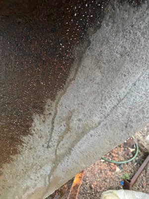

Port side, which I additionally de-rusted with aluminium dry, visible as silvery tracks on the surface. I doubt this would make a significant difference unless one had the considerable patience required to do it thoroughly, since the disk covers too small an area
Aluminiumizing the port side after overnight soak, with my formerly trusty drill having a last lie down before expiry - Ah, wont upload, must have exceeded an allocation or something. Never mind.

I grind with disks or cups made from the cans, both before and after applying the vegetable oil binder. The idea is that this forces aluminium into intimate contact with the surface of the steel, poor mans flame spraying stylee.
If you want flakes, aluminium foil provides them, but ive only used that when derusting by hand, as for tools, fastners or very light rust, I have thought about-putting foil inside a can that one then flattened intoa disk. Should work. But havnt tried it.

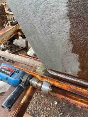

The mandrel seen here on my old dead drill is a bought one that I had from 20 years or so ago, before I went to Taiwan. One can make better ones, with less obstruction by the end nut, and more capacity, by cutting the head off a suitable bolt, which I will do soon.
This type of stacked-flattened-cans disk starts out spiky, with a lot of vibration, and in this form is probably most suitable for de-rusting, but it rapidly develops into a 'tyre', as seen here, which is more suitable for laying down metal, as long as the surface being abraded is a bit rough/pitted.

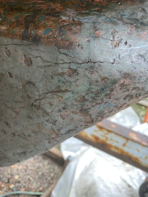

Didnt seem to work as well with the cast oron ballast keel. Not sure why. The surface is very irregular, with paint/antifouling/filler(?) in a lot of the pits, and this, and/or a self lubricating property of the cast iron itself, may have made it less efficient at grinding the aluminium.
The centre keel on a Trident 24 is also a peculiar shape, with a “notch” or “waist” running downwards from top front to bottom rear. This isnt intuitively faster (though I’m not a naval architect) and it makes it even more difficult to grind.
Also had some fine cracks in it which cant be a good thing, though I dunno how bad it isA245B995-EA07-48A4-8CCF-CDC80DBF3C8A.jpeg
