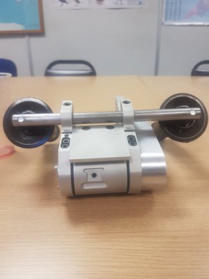

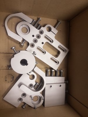

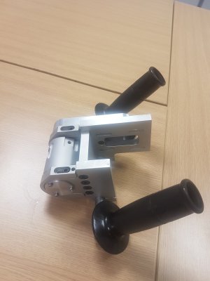

Thanks guys I’ve had a look at The one for sale but I was really after a proper gel plane , also I don’t think wood plane would work in my hull either

You must get a proper one. They are only an electric wood plane but with a bespoke front end/depth guide.
The rotating barrel is exposed at the front. Then there are two guides, one deeper than the other.
The one sits on the gelcoat and the other sits on the planed surface. You plane off in stripes half the width of the rotating barrel.
It’s exhausting. You have to keep the plane at 90 degrees to the boat and push it hard onto the boat or your cut depth will vary.
Getting the guide right so that you cut off an even stripe not one slightly deeper on one side is hard too.
