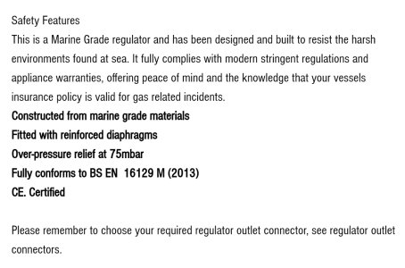

Is there a special salt water corrosion resistant calor gas regulator? Or do we just replace the usual regulator more frequently?
By 'often', I mean I've often recommended them to friends who have subsequently bought there. It's not because mine have failed and been replaced 'often'!
The Annexe M "marine" regulators are corrosion resistant.
They also have other features, such as an overpressure relief valve and a reinforced diaphragm , compared to standard regulators.

"Marine" = twice the price. 🙁
But it is required if the boat is to satisfy various regulations, such as the B. W. boat safety certificate, or coding to allow chartering. Also if you require a survey to renew your insurance, the discovery of a non-marine regulator will result in the requirement to fit one.
