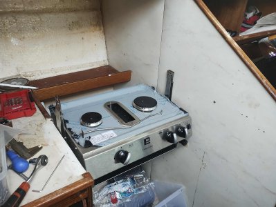

Installing a Tasman 4500 stove that came with a gimbal kit. Have installed it as seems correct on the bolt patterns and sort of looks like the manual.
However it seems quite flimsy, rocks from side to side quite a lot in a way that I have not seen a boat cooker do before.
Does this look right or am I missing something?
I could put spacers in to reduce the sideways gap but then the bolts start to contact and it doesn't swing well.
I think they are just rather cheap and flimsy. I didn't like the look of them and reused the cast alloy A brackets from my old Vanessa hob.
Looks ok to me. Does it matter that it swings fore and aft? Certainly I would not reduce its primary ability to rock back and forth, but I might ensure the one on the bulkhead was secure at top and bottom to reduce the fore and aft. The kit I bought for our stove is no better and we cook well enough on the move though we are coastal not blue water so only twice a year are we more than 10 hours from next port
My space is very restricted and my set up can only swing about 15 degrees of heel so I have pan clamps as well. We have 8.5m shoal draft boat - which originally had fixed cooker with poor clamps - so we wont be going out in expected F6 and if we do we will be too sea sick to cook - which is where crisps and dried fruit come in handy
You can tame the swing with either something like a 5 to 10mm D rubber ring or bungee cord wrapped loosely around the left gimbal.
Alternatively a V of bungee from the cooker front to rear, the centre tethered to the floor or the side wall.
Make your own from some scraps of wood, or angle grind some thinish staimlnless steel sheet to the shape you need
If you bend up the edges, or put a crease in it'll be plenty strong enough
