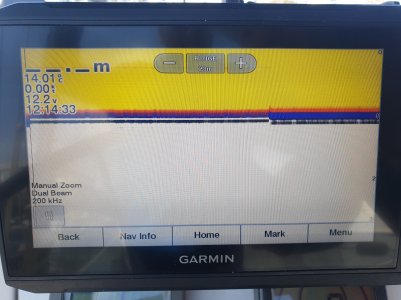

It's a new to them boat and the depth seems to just show dashes.
I initially suspected the transducer, but then realised that on the Sonar page, the depth looks to be correct... but still nothing in the depth box at top left.
Were in a marina in just over a metre of water.
Am I missing something in the setup?

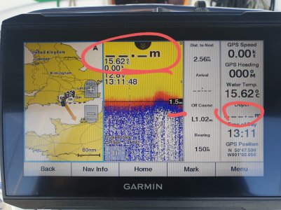

That's where I also expected to see the depth. We did have the 'Depth' data box showing at the corner of the chart view but it's data just showed '__:_m'
I then ended up going up their mast and fixed the steaming light and then the anchor light.
Back to deck level, I've not searched out the connectivity diagram, but could the sonar transducer only provide a 'sonar' style view and does the MFD rely on a separate depth transducer (e.g. the airmar DST whatever) that appears to not be connected?

The question is still about whether or not the 'depth' figure should populate itself from the reading that the sonar shows..
Sonar is directly attached and shows a clear image of the correct depth... but it's not populating either the sonar depth figure.. or the chart depth box .
With nothing else listed on the NMEA2000 backbone, there was no option to remove a redundant depth source...
I did however pop back to my boat and picked up a few spare depth transducers, after having found the end of their NMEA2000 backbone near the forepeak with nothing plugged into it..
Both of mine showed up on their bus, so I replaced their existing (unconnected) through hull transducer.. Depth now showing fine in the depth data boxes within the chart and within the sonar display.
I'm still intrigued as to whether or not the depth box should have been able to take it's values from the sonar transducer.. It feels like it should have been able to.
