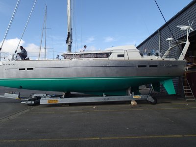

This is a photo I took while at the Garcia factory showing the underwater profile of the first exploration 45. Later models had a slightly redesigned cabin top.
The Garcia also has an all fiberglass cabin top (which is quite a proportion of the deck). This is one of the biggest drawbacks of both the Garcia and the Allures-the beauty of an aluminium monocoque structure that is all welded together to become a homogeneous structure is lost. The fibreglass cabin top or deck needs to be glued and bolted to the aluminium structure.
It depends on the details but overall, aluminium is lighter than solid fibreglass and about the same weight as cored fibreglass (exotic layups involving epoxy and carbon can, however, be significantly lighter). The primary reason both Allures and Garcia use fiberglass is that the complex shape of the deck and cabin structure is expensive and labour intensive to construct in aluminium particularly if aesthetically pleasing curves are incorporated. If using aluminium there are a large number of parts that need to be cut, shaped and welded together, popping a fibreglass deck out of mould is much more cost-effective.
Both the Allures and the Garcia are centreboard boats. This has many advantages, but as the keel is unballasted, a reasonable amount of ballast has to be added in the bottom of the hull to ensure adequate stability. As the ballast is higher the weight needs to be greater and the overall weight is high. This is especially true with the taller structure of the Garcia. The Garcia is also built for more rugged conditions (ice, etc.), so I believe the whole construction is a little beefier.
