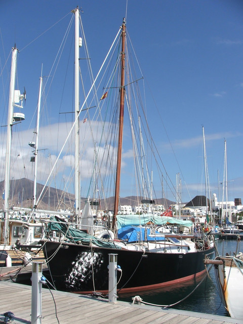

I used galvanised wire when I rigged my steel Gaff Cutter. Hand spliced, wormed, and parcelled, then served the splices with some tarred Marline that I bought from a Trawler Supply Company in Grimsby. A Classic yacht supply Chandlers in Norfolk sold the same Marline but at 4 times the price, so have a look round before buying.
Once I had set up the rigging I coated it with a mixture of boiled Linseed Oil, varnish and black Gloss paint. A similar process at sea in Merchant Ships was known as 'Blacking down' usually reserved for Junior Ordinary seaman..a bit messy..;)
I favoured Blacking Down after the rig was in place because when the coating, at least with my recipe, was dry it hardened, so movement IE bending etc: would crack the coating and allow the weather to penetrate to the wire.
Laying in a berth in the Canaries before crossing to the West Indies I went aloft and did a thorough check of my rig and was happy that after 8 years plus of continual seagoing, home waters and the Med, the rig and coating was still in excellent condition.
The Port side Top mast shroud in this photo may look white but that's sunlight on the shiney coating.

I wouldn't class the coating as Brittle really, there was some flexibility in the wire, it's just that I felt that any sharp bending of the wire while actually hoisting the ends aloft or dipping it around the temporary rope stays holding the mast up, might damage the coating.
The black paint was just a small percentage of the mix to give the wire a black look as the Linseed and varnish left it a horrible colour I thought.
I was working alone and the newly finished hull was afloat at the time. Working aloft in a Bosun's chair hauling the spliced ends up to the Mast Band meant the rigging did get a bit of a rough time but the home made coating mix held up well, as proved in later years.
You could experiment with different coatings until you find something to suit your particular needs. I know there are probably commercial products which would do the trick, but I was confident the home brew would work at the time.
