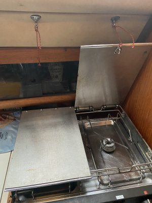

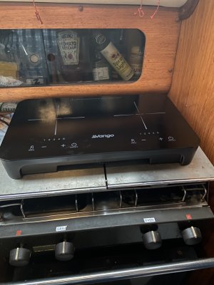

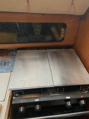

Tricky to find a pair of induction hobs that will sit in the 450mm width of the previous gas cooker. The Vango is 420mm so easy enough to fit and gimbal for use at sea. The original 1500w single induction hob lives underneath as a spare.

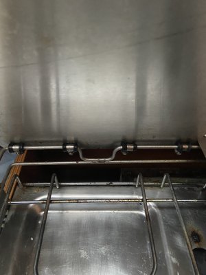

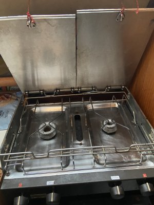

i fitted two split 3mm stainless sheet tops that are hinged on the back pan rack, lift up when cooking on either burner and then just sit down to use the top for others stuff, looks neat and tidy and now perfect for sitting hob on and still gimballed
Interesting, do you have a photo?

I would interested to hear if the stainless steel plates get hot after you have used the Vango for a while.
Nice install and easy to keep clean (y)

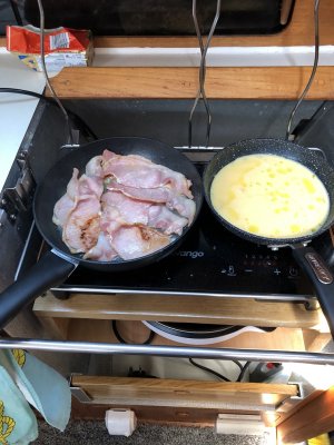

I added a small counter weight the equivalent to a cup full of water to my base. This causes the Vango to slope slightly towards you without a pan. larger pans can therefore be moved towards the back a bit which makes accessing the Vango controls easier. The Vango can also be used in the cockpit if you want, say cooking bacon on Sunday morning whilst rafted up to lots of other yachts :giggle:

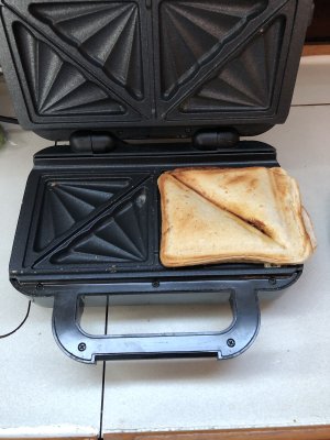

Found a 750w Breville panini thing at home, so that is now on the yacht too. Brilliant for making quick snacks whilst at sea.
