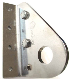

Every time these discussions come up, I end up envying people who have cutters or removable inner forestays. I will probably add a removable inner forestay eventually but am a bit uncertain about how strong the top-end attachment point needs to be and how it can be constructed - some masts you can buy purposemade parts but mine is too old.
Wichard mast fitting
This fitting comes in two parts which can be slid into a slot and then bolted together entirely from outside the mast. Pop rivets then hold the flanges inside the mast.
This one for 6-10mm forestays was a bit large for my 8m boat so I made one up from 2mm stainless instead of 3mm. Very easy to make and almost zero cost.

No need to adjust the backstay but you need some way of tensioning the inner forestay. Mine came with a Highfield lever which tried to bite me every time I used it and never really developed enough tension. I replaced that with a Wichard ratchet tensioner which is the bees knees and can be operated with one hand - but it was hideously expensive.
