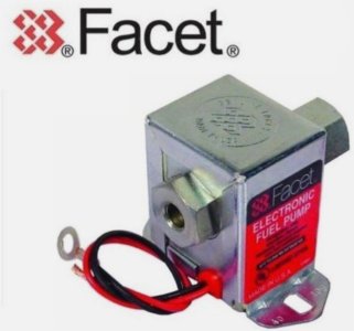

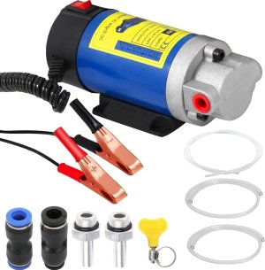

Diesel pumps on eBay seem to be like the one pictured, maybe mostly aimed at draining oil sumps or something, but they appear adequate; I’ll happily accept recommendations though! The Racor FG500 knock-offs say they’re good for a little under 4 litres per minute. The pumps are available at rates much higher, and I don’t know if that would be a problem for either the filter or the pump. Should I deliberately seek a pump that tops out at, say, 3lpm?

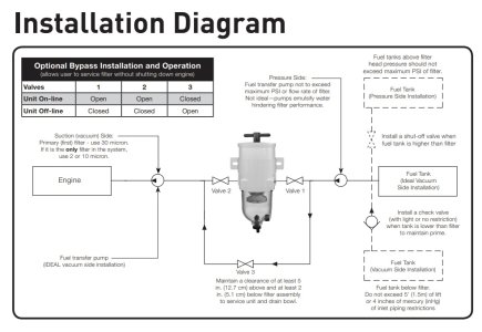

And, should the pump ideally be pushing or pulling through the filter? As in:
big tank -> pump -> filter -> day tank
or
big tank -> filter -> pump -> day tank
