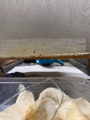

My fuel tank is deep in the bilges and I have long suspected that it has a very, very small leak as there always seemed to be barely visible "snail trail" from the tank. It is between two full depth floors so you cannot see any of the tank other than the top - so I bit the bullet and took the tank out, stood it up on the bench, added a quarter fill of fuel and waited ............................. After a day nothing showed up so I picked off one scab that looked like a rust blister (but the tank is aluminium!) and hey presto, there is a tiny pin hole leaking fuel out. And I mean tiny, as although it leaks it can easily be stopped with said pin. I guess that with more head of fuel the "blister" was leaking out.
Don't know why/how the hole is there as the aluminium looks fine and the tank is suspended and does not touch anything. Anyone any ideas?
As the hole is so small (and unless I find more holes) I thought to plug it with a small bolt and two rubber washers and paint the whole tank with a bitumen based paint or similar?

I'm pretty sure that what is on there now is Hammerite Special if I remember correctly - I had the tank out about 10 years ago to cut an access hatch in it. I was thinking bitumen so as to build up a membrane to cover any imperfections that cannot be seen?

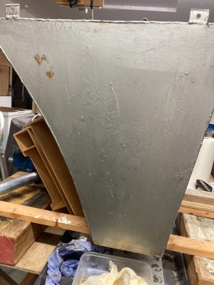

Looking at the surface pictures, there appears to be other "bits of rust" - the odd bits that are proud of the surface paint etc.
Possibly there was some grinding (of iron / steel) going on in the vicinity of the bare tank and there's some dissimilar metal nonsense going on under the paint?
Yes, that's what I thought. Some steel touching the tank.
I had an aluminium tank in my car, due to it standing about in store for 3 years - condensation had built up inside the tank causing the steel fuel pump and level gauge to go very rusty inside the tank. over time this rust flaked off and sat in the bottom of the tank and corroded the tank in small spots from the inside out causing the tank to become porous with many tiny pinholes. I wonder if you have a bit of the same happening in which case this could be the one and only hole or the beginning of a lot of them ....If it was me I would be looking inside to see what is happening.

Is it worth removing all the paint on the outside of the tank to check it out ?
If one hole has appeared maybe more are on their way ?
Very sound advice and based on the signs of some more rust in other areas in the photos (which suggests this is a steel tank) and that it is impossible to inspect or paint in situ I would consider getting a new tank made from a material that does not rely on a paint film.
Wondering why it has been painted. What are the brown stains by the welds ?
I took it out about 10 years ago and cut a hatch opening for cleaning - which is how I know that it’s aluminium. Brown staining below the pinhole is most likely caused by several years of diesel quietly leaking out
No, but I did cut a big hole in the top for an inspection hatch. It’s aluminium
The brown that you can see at the bottom of the tank below the weld is some cardboard that it’s resting on to prevent staining the bench. Sorry if it has misled anyone ☹️
