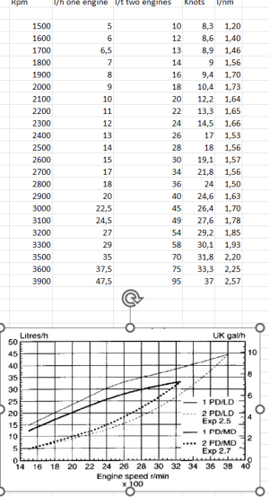

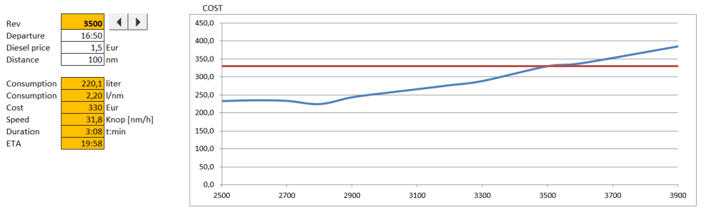

A simpler approach may be to use Information from the engine consumption curves. I made an excel spreadsheet 8 years ago for my Windy 9800 with two AD41p-a engines. The curves give a good estimate for trip cost vs different rpm.
You only need to log the speed at different rpm. The curves requires a "perfect" propeller for the boat, but you could do a test run, refill, and adjust the formula with a percentage. Not sure how I can share an excel file.

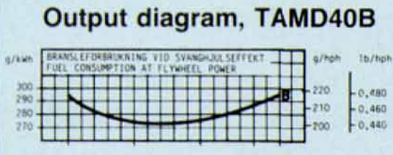

We are maybe a bit off topic, but I would expect the fuel consumption [g/kWh] is covered, as both the fuel and hp can be related to rpm. I could not find the fuel consumption in [g/kWh] for aqad41, but found for aqad 40 in a technical bulletin (older different motor :)).

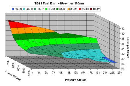

I fly a small plane where the ballpark figure for fuel burn is 50 litres an hour (at over £2 a litre) so I produced this from the tables in the manual and worked out the optimum power settings for min fuel per nm.

Absolutely, flights are always planned to take advantage of the winds and it's better to fly slowly with a tailwind (maximise exposure) or faster into a headwind. The table is for still air and so it's easy to cross reference it to SOG in flight. Even planning software for light aircraft flights (Skydemon in the UK or Jeppesen Foreflight in the USA etc) can work out most efficient level to fly given forecast winds.
