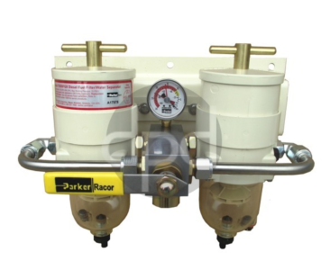

The gold standard is the double Racor 500, with the vacuum gauge, and which you can switch on the fly.
It's expensive, and the Chinese knock-offs might be good enough. Or might not be.
I keep a 2 micron filter in one side of my Racor, and a 10 micron in the other. I use the 2 micron every day -- which is as fine as the standard Yanmar secondary, which means that as long as the Racor is clear, nothing is accumulating in the secondary.
If you see the vacuum going up, then you switch over to the other one, without shutting down the engine, and replace the clogging 2 micron filter.
In 15 years with this boat, I've never needed to do that. But having had fuel problems in two other boats, I'm paranoid about it.
That sounds like an excellent setup.
