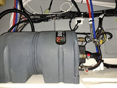

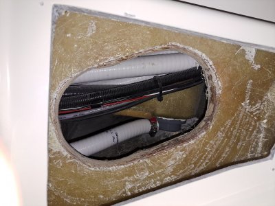

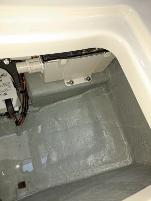

Day 5 of the Quicksilver 905 WE fresh water leak saga: By blocking the various drain holes I have determined it is definitely not the water tank or main water pump or anywhere in the aft of the boat.
Someone mentioned that the boiler drains into the bilges but you will see from the photo mine vents overboard.

I have opened the inspection hatch in the heads cupboard under the sink but cant really see anything as access is very difficult – I have run my hand up and down the pipes and they don’t seem wet. I don’t see how to remove the sink shower faucet.
However, I did not know I had a shower sump pump and every 10 minutes or so I get a pump surge from that area. This is even when the water pump is turned off behind the galley. Don’t know whether this is linked. Also how does one turn on the shower sump pump as I cannot find a switch for it.

Also heated the boiler up to see if when the water was hot it leaked but made no difference. There is a very tiny droplets of water under the boiler relief valve but I honestly don’t think that is anything.
