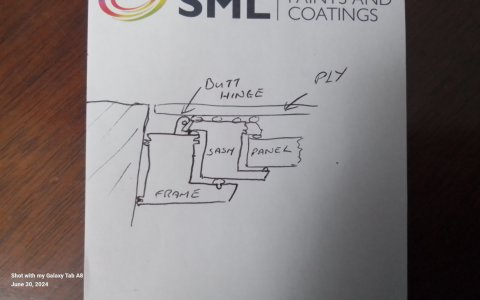

You could actually recess the pvc frame so top of sash is 10mm below counter top surface and bond some ply over the top to give a flush finish

If you go the uPVC route and your wallet is healthy you could choose a frame matching a common size and instead of encasing the whole thing in wood, or insulated panels, have double glazed door - and then you might be able to see inside without opening it.
Jonathan
The u-value of a glazed unit won't be as good as a few inches of closed cell polyurethane foam, although it would be a neat idea.
