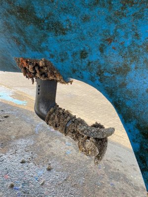

Just a follow up, after our lift out a while ago, hull was ok just a bit of slime on the hull but no growth. No growth on the sail drive leg.
Propellor, however, a lot of growth, after scrapping that off raced back down the Orwell with a through the water speed of 5.75 Kts, Happy days!
