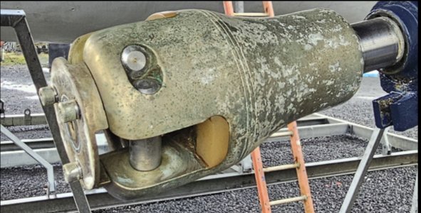

2 or 3 bladed?
I think the smaller GORI style prop removers will also work for FlexoFold, same idea of put them under the pins and use a central bolt to remove the prop
Measurements I have for FlexoFold is 30mm wide bar and "wings" which is same width as GORI removers
Alternative is a piece of 30mm x 20mm bar with a threaded hole through it

Three blade with 30mm wide blade root. Didn’t know the Gori puller would fit. IMG_2253.jpeg

interested in this as I had a heck of a job getting mine off. I had to use some heat a hammer and a puller that didn't quite fit
