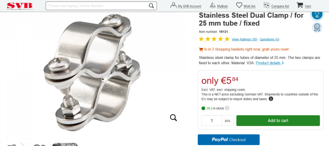

As I understand it - you want dual pipe side by side clamps - but the pipe sizes are different.
I would be inclined to drill through both pipes and put a bolt and dome nut in ie two places ... but first pushing in wood dowels of suitable size into the pipes to provide internal support so the nut / bolts do not crush the pipes.

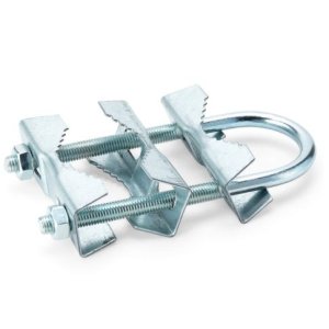

A couple of pipe clips or saddles back to back, one of each size obviously, then bolted through might help to get a solid connection? Or make spacers to suit the two diameters. I've done something similar in hardwood, plastics might be another option.
