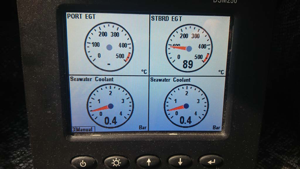

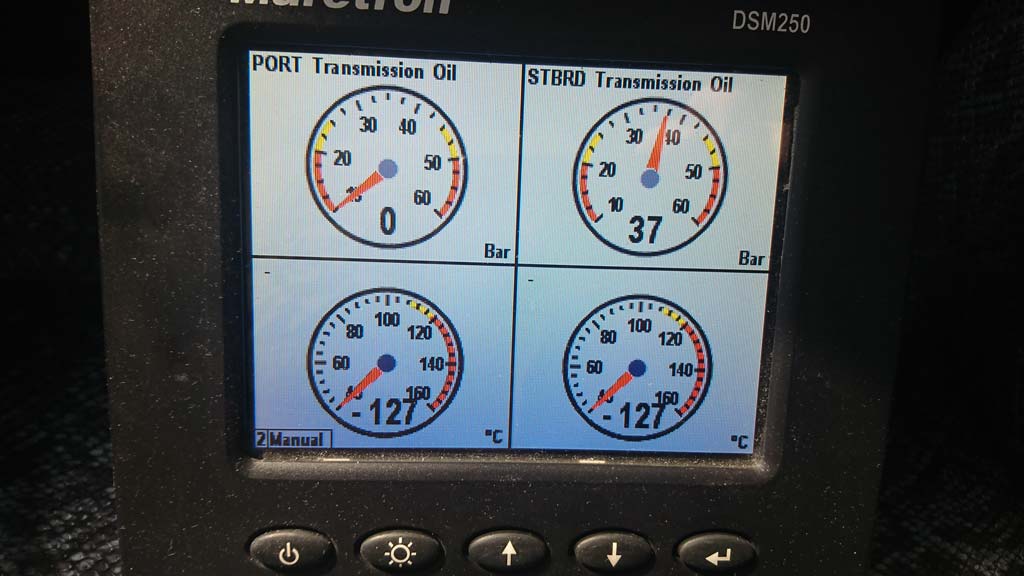

I'm becoming a bit of a datacholic and I've managed to have even more data on the N2K bus than on the lower helm dash :D
down to EGT, g/box oil pressure & temp, seawater pressure, boost, coolant temp, etc
DSM250 looks like this (ignore the -127C, still testing and not all sensors connected, plus port engine is in bits as I'm servicing heat exchangers and drilling for the pyrometer sensor):
mind, Garmin GMI10 is similar, graphics are better in the Garmin (and it's way cheaper...)
