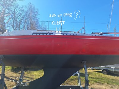

Decided I had to agree all manner with the yard where my 38ftr is .... so they don't have to keep calling me about moving her to access another or whatever.
While there added to the list of jobs for them to do ....
I have never understaood why boats are made without midships cleats .... an item that makes even a big boat a pleasure to put alongside.
Anisette has the usual L shaped alloy toe rail bolted down to deck.... at bow - she has a cleat each side using same deck bolts of the toe rail, cleat angles slightly in .. so I got guys to photo the bow cleat and asked them to fit same just ahead of midships in same manner.
Luckily these do not need toe-rail cut in any way s the cleat sits slightly higher than top. No need for fairlead either.

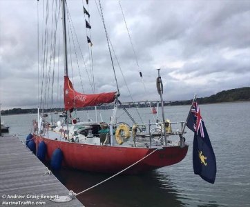

Parking this would be impossible without midships cleats.
Short line on midships cleat. Bow and stern lines led outside everything and bowlined to stanchions adjacent to the midships (bowlines are safer - don’t want rope round prop!) Get short line on, get uptide line on, get downtide line on. Add springs, ease breastropes. Put kettle on.
