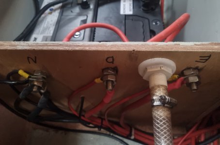

I know not everyone are Nigel Calder fans but he makes a very good case over the issues of stainless steel in the conductive circuit.
Not suggesting putting stainless washer between terminals/lugs, but it would be very unlikely to get hot enough on most (all?) boats to cause a fire.
I recently did a Lithium installation on a boat where someone (a so-called "pro" i believe) had drilled holes in the side of the battery compartment and put stainless studs through the holes, each end of the studs had a washer and a stainless nut, all tightened up. The battery cables were connected to one side and all of the loads to the other side. Note, in particular, that the negative stud carries all of the current throughout the boat!!
But, nothing caught fire and the plywood isn't even scorched.
I'm not expecting that to be the cause of this fire but having seen too many boats go up from electrical faults, when I was doing my electrical apprenticeship, bad practice was always frowned upon (like stainless in the conductivity path) and on boats, I am even more thorough, even if it's mostly for my own peace of mind.
