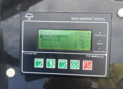

Here‘s mine last Sept ( annual early June ) Med based but the principal is identical.
Rated manufacturers WOT for the engines is 2200 rpm .
I have seen 2276 rpm on launch day after an annual , so it’s about 40 rpm down , but its within spec that’s the main thing .
Overloading occurs across the rev range if it’s overloaded.The only way to tell is to WOT it.Ideally if not mega electronic at a sea trial get a tacho on the fly wheel . But for simple diy “ is it propped correct “ “ is it fouled “ ? Then WOT it and see .
The speeds pretty irrelevant really you need to get see it’s max rated rpm and go from there .If it can’t reach it = further investigation is required .
